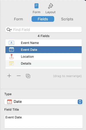

To utilize the Calendar view, you must create a “Date” or “Date & Time” field when setting up your records. To do this:
- Open the Form sidebar
- Click the “Fields” tab
- Click the + icon to add a field
- Select either “Date” or “Date & Time” from the dropdown menu
